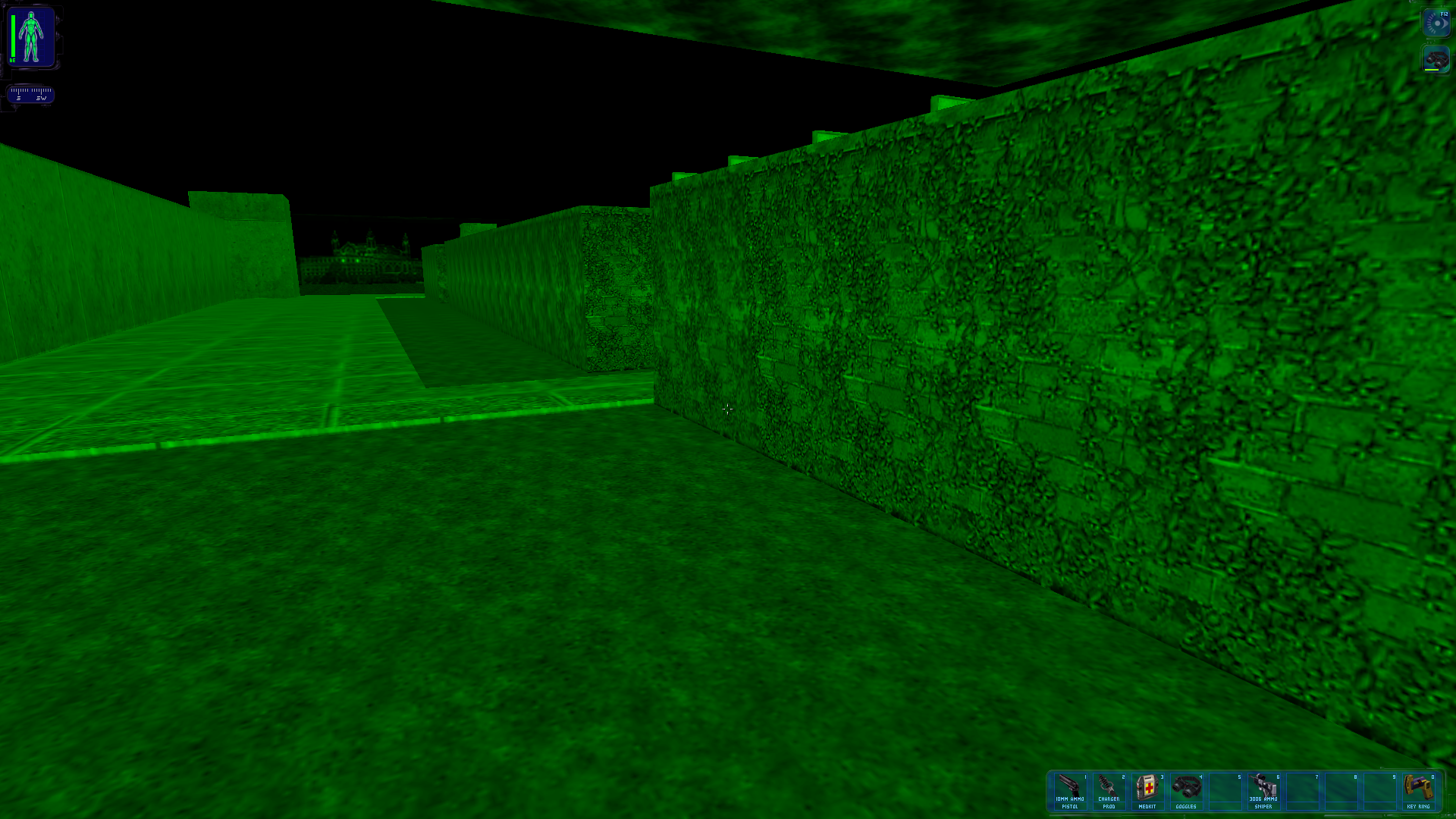

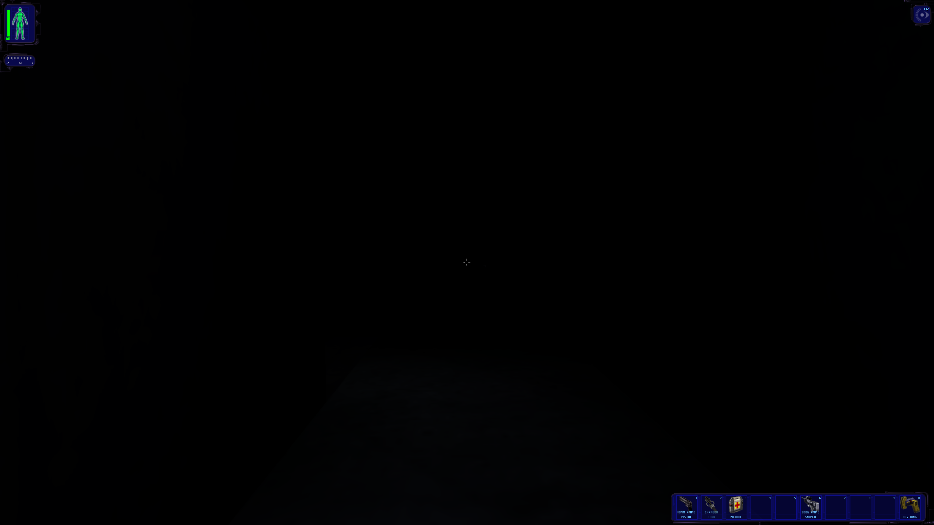

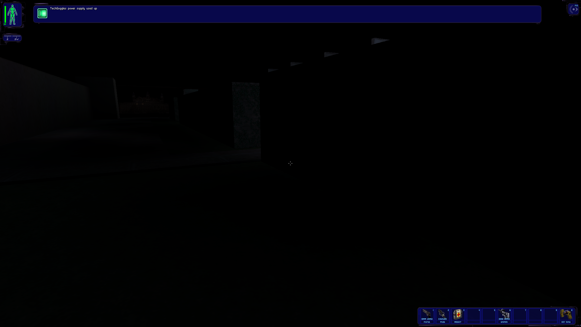

Basically i just toggle the NoLighting bool... the AI still thinks im in the shadows even though for me there are no shadows, it works a treat... I also laughed because now i have to lower the brightness so that its not so intense
heres another question for ya though..
where is the destructor for the game loop, or if theres something similar, like a function that runs on exit?
all id need to do is set nolighting to false and the brightness to your "savebright" variable so that it always defaults on exit.
ahh success... it feels great doesnt it? ill send a few screens if i can figure out how to attatch them.
Edit: SolidGreen on its own was too intense, VisonBlue on its own was a too intense, but solidgreen with visionblue layered on top of it works really well, its weird..... and although it shows the border of the skybox and other things that arent supposed to be seen during gameplay, at least the nightvision works like it should.
Edit2: Ok so ive managed to find function PreBeginPlay() under Engine\classes\GameInfo.uc... from there i set NoLighting to false so that its always false on startup regardless of the ini file, im sure noones going to miss it :P
works a charm, but a new problem arises, i had to use WOTGreal Package exporter to export the images in that package to recompile engine.u, but there all named by their "given" names, not their original file names, so i renamed them to the correct name, compiled successfully with no errors or warnings but for some reason, SmallFont.bmp... the only bmp it asked for... doesnt seem to work in the game.. its the font for the console\talk for entering commands. Its not corrupt or anything... perhaps theres a better function in DeusEx/classes for this i havent found yet..
Is there a way to just recompile any changes in the source or do i have to recompile the whole thing from scratch including the images?
i really hope someone sees this and puts this in the next Revision update, or any of the other "improvement" mods.
Before:
Before
(258.21 KiB) Not downloaded yet
After:
After
(1 MiB) Not downloaded yet
Before:
Before
(106.85 KiB) Not downloaded yet
After:
After
(554.67 KiB) Not downloaded yet
Sorry for the "Wall of Posts" :lol:

         gc.DrawText(x, y, w, h, msgIRAmpActive);
Next i find line 1357 and modify as follows:
   // shift the middle of the screen green (NV) and increase the contrast
   // DEUS_EX AMSD In singleplayer, draw this here
   // In multiplayer, drawn earlier so you can still see through walls with it.
   if (player.Level.Netmode == NM_Standalone)
     gc.SetStyle(DSTY_Modulated);
    gc.DrawPattern(0, 0, width, height, 0, 0, Texture'VisionBlue');
    gc.DrawPattern(0, 0, width, height, 0, 0, Texture'SolidGreen');
     gc.SetStyle(DSTY_Normal);
   if (player.Level.NetMode == NM_Standalone)
      DrawDropShadowBox(gc, 0, 0, width, height);
   // draw text label
      gc.GetTextExtent(0, w, h, msgLightAmpActive);
     if(visionLevel>=1)
      x = boxTLX + margin + width/2;
     else
     x = boxTLX + margin;
      y = boxTLY + margin - h;
      gc.SetTextColor(colHeaderText);
      gc.DrawText(x, y, w, h, msgLightAmpActive);
Here i have changed the first instance of 'SolidGreen' and changed it to vision blue, changed the width and height to the resolution of the screen, then i comment out the last two if statements as the first one is the thin white border where the mini lightamp window would be and the other is the string "LightAmpActive" that would be on the top left of that window, both of which are not needed anymore as i know the "LightAmp" is active because my whole screen is green now :P
Moving on....
Save that mofo, then open up augvision.uc
line 25, under function activate() and function deactivate() somewhere i added these new lines of code
function Activate()
   local bool bWasActive;
   bWasActive = bIsActive;
   Super.Activate();
   //NEW=======================
   Player.ConsoleCommand("set ini:Engine.Engine.ViewportManager NoLighting" @ True);
   Player.ConsoleCommand("FLUSH");
   if (!bWasActive && bIsActive)
      SetVisionAugStatus(CurrentLevel,LevelValues[CurrentLevel],True);
      Player.RelevantRadius = LevelValues[CurrentLevel];
function Deactivate()
   Super.Deactivate();
   Player.ConsoleCommand("set ini:Engine.Engine.ViewportManager NoLighting" @ False);
   if (bWasActive && !bIsActive)
      SetVisionAugStatus(CurrentLevel,LevelValues[CurrentLevel],False);
      Player.RelevantRadius = 0;
save that sucker and open techgoggles.uc
here we have ChargedPickupBegin and ChargedPickupEnd functions, in there i added these new lines of code
function ChargedPickupBegin(DeusExPlayer Player)
   Super.ChargedPickupBegin(Player);
   DeusExRootWindow(Player.rootWindow).hud.augDisplay.activeCount++;
   UpdateHUDDisplay(Player);
function ChargedPickupEnd(DeusExPlayer Player)
   Super.ChargedPickupEnd(Player);
   if (--DeusExRootWindow(Player.rootWindow).hud.augDisplay.activeCount == 0)
      DeusExRootWindow(Player.rootWindow).hud.augDisplay.bVisionActive = False;
save and lastly i open up DeusExLevelInfo.uc
At line 42 you will find function PostBeginPlay()
i modify as follows:
   Super.PostBeginPlay();
   Level.ConsoleCommand("set ini:Engine.Engine.ViewportManager NoLighting" @ False);
   Level.ConsoleCommand("FLUSH");
   SpawnScript();
save that, goto your deusex\system folder, rename deusex.u to deusex.u_ or something, just to keep a backup, then run ucc.exe make
All done, start the game, summon techgoggles, augadd augvision then allaugs and test your fancy new working nightvision.
a few things to keep in mind would be that, it removes the lighting, so you will be able to see things that the developers didnt intend for you to see, skybox borders for instance, where the map ends when looking in the water on liberty island and such, and when talking to someone it will disable the green filter but it will still be full bright due to the nolighting bool still being true whilst in these situations.
And theres my take on fixing the NightVision in deusex :)
never been done before until now :P
