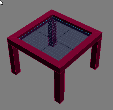

Hi my names _Nick_, after going through Hell with very vague directions to getting there, I've finnally sucessfully imported a mesh into Dx :) Using 3dstudioMax 9 An 3ds2de...
after doing so i got a working model. Now to texture it...
As the first model i used was very basic, I just used the multiskin variable in the properties for the mesh in DX, to see what the form of the model looked like in the editor. I'm rdy now to take the next step. My friend Ninja has created a simple model of a little table with a simple plane in the center that I would like to import and texture INTO Dx. The table will be one simple flat texture, an the plane in center of the table I would like to just set to Translucent. Any chance of a tut on which method to use for texturing?. Should I use Bitmap? convert it to 256x256 an convert to a *.pcx file? I've learned that I must name the Material Translucent so that when I import it will have that effect on it.... but i'm confused.
Here is the model my buddy Ninja made that I am using: BELOW
I just want one texture for the table an I dont care if its the same texture for the glass just as it will be set to translucent... I think i mainly need help understanding the *.uc stuff an which method for setting the effects..
I have read http://tack.planetdeusex.gamespy.com/3d ... odels.html
I have read this section on Texture Mapping, an Fixing Texture maps...
I have been able to apply a texture map to my model the correct way I just need to know how i am supposed to set 2 textures to 1 model?....
or how to set 1 texture part to a part of the model an a secnd part of the same texture to a different part of the same model... hope thats easy to understand...
Also After trying I realised no matter what i did I couldn't import a model with 2 seperate objects... example: table object an translucent plane object... the 3ds2de tool would give me errors... like

Plz help? My last resort would be if You could go through the steps an share with me the *.uc file u used to make it work? FYI i have already set the plane in the center to a standard Material with the name Translucent an the Opacity 50%. Thats all I set.
My *.UC file looked like this for a single object just the table trying to set it to translucent
without the plane an material for it named TRANSLUCENT an set to 50%opacity is this correct?
// tablemodel.
class tablemodel extends DeusExDecoration;
#exec MESH IMPORT MESH=tablemodel ANIVFILE=MODELS\tablemodel_a.3d DATAFILE=MODELS\tablemodel_d.3d X=0 Y=0 Z=0
#exec MESH ORIGIN MESH=tablemodel X=0 Y=0 Z=0
#exec MESH SEQUENCE MESH=tablemodel SEQ=All STARTFRAME=0 NUMFRAMES=1
#exec MESH SEQUENCE MESH=tablemodel SEQ=glasstable STARTFRAME=0 NUMFRAMES=1
#exec TEXTURE IMPORT NAME=Jtablemodel1 FILE=MODELS\purple.pcx GROUP=Skins // TRANSLUCENT
#exec MESHMAP NEW MESHMAP=tablemodel MESH=tablemodel
#exec MESHMAP SCALE MESHMAP=tablemodel X=0.00390625 Y=0.00390625 Z=0.00390625
#exec MESHMAP SETTEXTURE MESHMAP=tablemodel NUM=1 TEXTURE=Jtablemodel1
defaultproperties
DrawType=DT_Mesh
Mesh=tablemodel
pic of it
