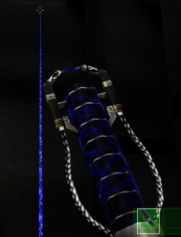

This is what the beam effect should look like in-game :D
