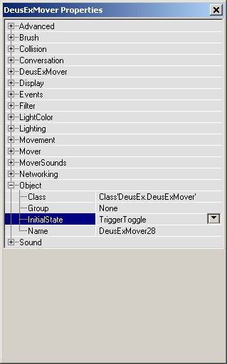

I've a Deus Ex mover controlled by a switch2. What I want is that when I press teh button, the mover move to his position and keep it till the button is pressed again. How do I do that ?

This is default behavior. Make sure that initialState of your DeusExMover is TriggerToggle

Yes, the initial state is set to Trigger Toggle.
I'm trying to do something like the mover on the pit of Funline_Unlimited Party 3 but it keep return to the start position after the 28 seconds ^^
