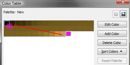

You need to tick "Masked" option while importing the texture in UnrealEd, or if you're doing exporting with Unreal script, specify this is in the export code.
I personally don't use Photoshop, but in my program I had to open the palette and manually move the color to the very beginning of it.
