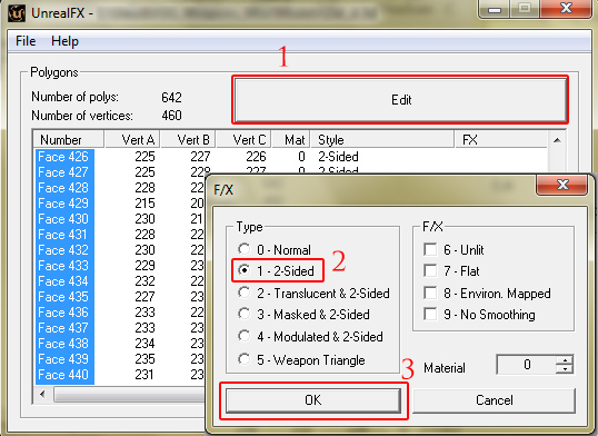

Postby ~DJ~ » Sun Aug 08, 10 2:30 am
Why are you viewing model in the program? Just get the group-names, select faces and set them to whatever you want.
The view on this program fails, this program is beta (never progressed anymore I think). Aside from the view, everything else works perfect.
This image will explain everything to you..
EDIT: And sorry, this is not material related, it's the model-groups. It makes model-groups MAT. The number is based on of how many groups you have in the model, and then you set each group's stuff to whatever you want.

Postby WeeCrab » Sun Aug 08, 10 3:14 am
It works - yeah, I saw the jumbled model and thought it would save it that way (or that I had messed up somewhere)
