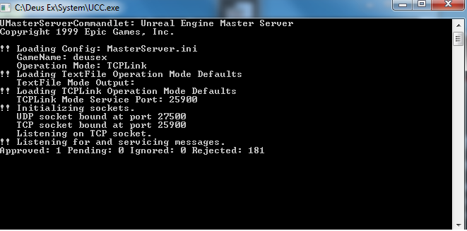

Postby -HDD21- » Mon Apr 07, 14 8:43 pm
Hello didnt see this topic when I added my other so sorry guys
My backup ms is running mine is one of the official unreal 227 backup masterservers, but also have one for Deus Ex
The other topic has it all: master2.oldunreal.com port is 27500 for uplink
And its query port is 25900
I put instructions in a topic on thc forums and the other one here options for ini change is either the community persuading steam to update inis and edit inis of any filesharing isos anyone might do however being a very quiet game the inevitable was due to happen a mod that allows viewing of multiple masterservers is an idea especially due to the nepthys rejection bug of UCC. I am amazed it held out this long the unreal community had backups established with 227 years back
Jacob
EDIT: someone else is attempting to uplink but a mismatching nepthys version results in what is shown here on the MS log, if its a paid server the IPDrv and Nepthys DLL versions are supplied in this file you need to replace them to the later version which is the same version the masterserver bears:
Note that 181 is the ammount of heartbeats rejected since i reset the application, if we have multiple masterservers if one hosted say a non-Nephthys MS, and an MS with the alpha version of Nephthys and have the game query them all with the mod, or somehow get zoras and developers/steams permission to preinstall Nephthys of the correct version so any new player's games that are hosted match this version or have it in a patch. This is a problem we face with UCC, according to zora it was due to incorrect keys for deus-ex that were used.

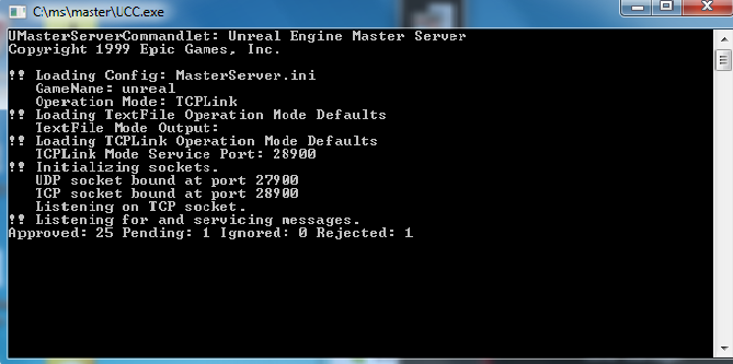

the other screenshot is my unreal masterserver and that one is populated
