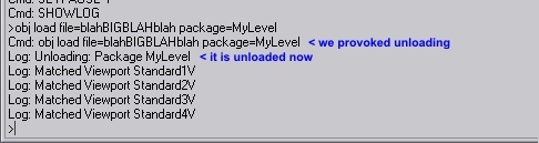

To say truth, your map file (.dx / .unr) is a package aswell. And yes, you may include classes, models, textures, sounds into the map file and you will get rid of loads of corresponding packages in this way. In case with this mod, you have to do that. Merge MapNameChecker package with the map package. It isn't hard to do - read a nice tutorial about embedding code. Before you do step 3 in that tutorial, you will have to unload MyLevel package (they forgot to write about that). Just type something like
obj load file=blahBIGBLAHblah package=MyLevel
and only after that, you may type the following command:

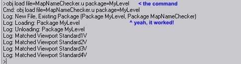

obj load file=MapNameChecker.u package=MyLevel
If everything is successfull, refresh UnrealEd classes browser (check and uncheck "Only show actor classes" option for this)

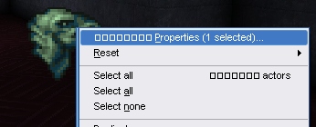

After you succeed in that step, "expand" the MapNameChecker (click on +). You will see a child-class with some odd name (boxes or lines).
Add this weird-named class to your map (it looks like eagle when placed). Then, use right click on that placed "eagle", go to properties:

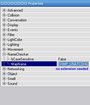

In properties, go to MapNameChecker. You will see two variables.
MapName - type your map's filename without extension.
bCaseSensitive - when true, also disallows changing lower/upper cases in name. We don't recommend using it.
