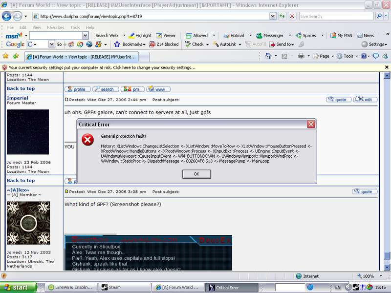

uh ohs. GPFs galore, can't connect to servers at all, just gpfs
Postby Alex » Wed Dec 27, 06 4:08 pm
What kind of GPF? (Screenshot please?)
Postby Imperial » Wed Dec 27, 06 4:18 pm
[ img ]http://img146.imageshack.us/img146/7894/gpfnewmodai5.png[ /img ]
Admin: next time use .jpg format. Your .png picture was 10 times bigger than my .jpg.
Postby Dae » Wed Dec 27, 06 4:41 pm
Can we have your DeusEx.ini?
