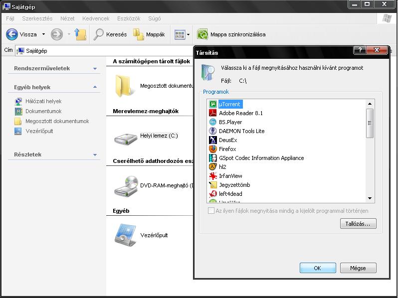

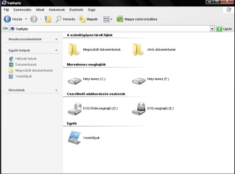

I have two partitions, C: and F:
When I try to open C:, it asks me to use a program which I can use for opening. Even though when I open F:, everything's normal, it gets opened the way it's supposed to. I'm attaching screenshots. Anyone knows what I should do? I tried using explorer.exe to open C: and it worked but it won't remember the process so whenever I want to open C: I need to do it again and again. So instead I'm using Total Commander but you might understand that it's a little bit uncomfortable. :(

You have a virus most likely.
Do a virus scan. If it doesn't fix your problem press Start > Run > cmd > type "cd C:\" without quotes > type "dir", then find "autorun.inf" and delete it with "delete autorun.inf".
If you copy the output of "dir" command I can tell you what else you can delete.
+ until you do it, you can still access your C: drive if you type C:\ into the URL bar.

Postby Alex » Thu Aug 20, 09 12:18 pm
It's a virus, definitely.
Your anti virus is blocking it.
You can access your C:\ drive if you right click on it, and press 'Explore'.
