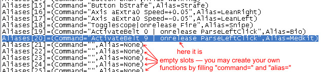

Did you set "medkit" command in "aliases"? An "alias" in user.ini means a user-customisable function. "Medkit" isn't a function that exists in Deus Ex, so you have to pre-define it in aliases beforehand.
You may find a section with Aliases when you scroll to the very end of the file and scroll up approximately 6-10 lines.

EDIT... Damn it hast worked, heres what i put in Aliases[18]=(Command="ActivateBelt 9 | onrelease ParseLeftClick",Alias=Medikit)

Alias=Medkit, not Medikit
