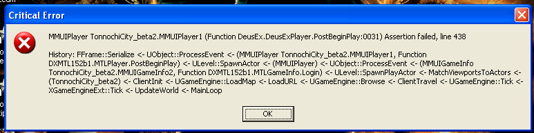

What the hell? I can open it in SDK but not DX. I really need help here.

Postby Alex » Thu Sep 06, 07 11:27 am
Where do you try to use it!? As a client, or as a servermod? :S
Postby Kaiden » Thu Sep 06, 07 1:51 pm
Um.. try..
Did you Compile it before saving?
Is there atleast one spawn point?
Do you have all the mods/textures/sounds etc, used in the map, in the right /DeusEx folders?
Have you altered the dx.ini before last opening it on DX?
RESPOND.
Postby Tonnochi » Thu Sep 06, 07 7:08 pm
Compile?
Yes
Yes
No
It's easier to uninstall MMUI. It's not worth having with all of these errors. I'll wait until there is a stable release to install it again.
Postby Alex » Thu Sep 06, 07 7:10 pm
How. do. you. try. to. use. it. As clientside mod or as servermod?
Postby Tonnochi » Thu Sep 06, 07 9:15 pm
(>open TonnochiCity_Beta2
It's a map not a mod.
Postby Alex » Fri Sep 07, 07 7:11 am
MMUserInterface is! Please, post your DeusEx.ini

Postby Alex » Fri Sep 07, 07 10:27 pm
Ok. You placed more than 1 DeusExLevelInfo object in your map. The problem is not because of MMUserInterface.
Postby Tonnochi » Sat Sep 08, 07 1:59 am
Oh, I see.
