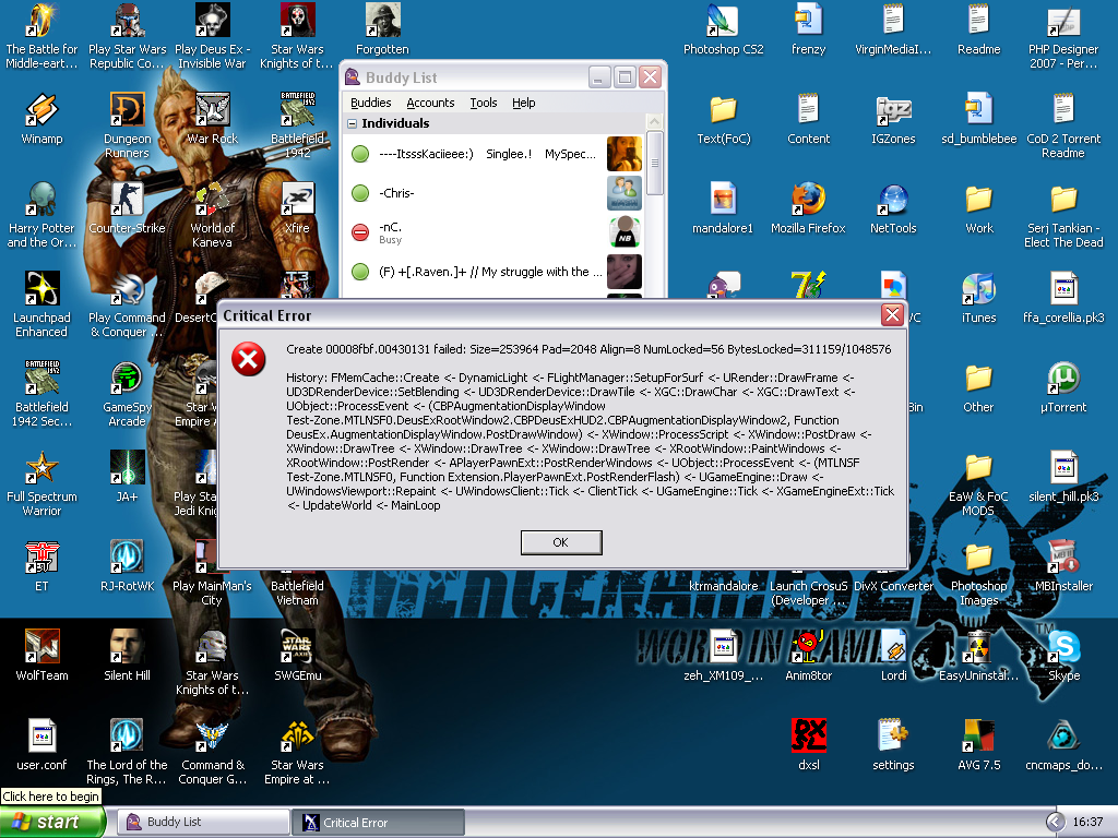

Postby Gishank » Mon Jan 28, 08 5:39 pm
Here's an image of it, help pl0x?
Postby Kaiden » Mon Jan 28, 08 9:34 pm
Looks like some renderer issue, try changing it (Follow the guide in the KB)
Postby Gishank » Tue Jan 29, 08 10:33 am
Well, the fact is, my DX *was* working the other day. And i haven't made any changes to my Deus Ex, nor have i made any changes to the core of my pc =/
Postby Kaiden » Tue Jan 29, 08 12:10 pm
Post DeusEx.log please after error occurs.
Postby Gishank » Wed Jan 30, 08 9:48 am
Log: Possessed PlayerPawn: MTLNSF Test-Zone.MTLNSF0

Critical: appError called:
Critical: Create 00008fbf.00430131 failed: Size=253964 Pad=2048 Align=8 NumLocked=56 BytesLocked=311159/1048576
Critical: Windows GetLastError: The operation completed successfully. (0)
Exit: Executing UObject::StaticShutdownAfterError
Exit: Executing UWindowsClient::ShutdownAfterError
Exit: UGalaxyAudioSubsystem::ShutdownAfterError
Exit: UD3DRenderDevice::ShutdownAfterError
Critical: FMemCache::Create
Critical: DynamicLight
Critical: FLightManager::SetupForSurf
Critical: URender::DrawFrame
Log: Anomalous singularity in URender::DrawWorld
Critical: UD3DRenderDevice::SetBlending
Critical: UD3DRenderDevice::DrawTile
Critical: XGC::DrawChar
Critical: XGC::DrawText
Critical: UObject::ProcessEvent
Critical: (CBPAugmentationDisplayWindow Test-Zone.MTLNSF0.DeusExRootWindow2.CBPDeusExHUD2.CBPAugmentationDisplayWindow2, Function DeusEx.AugmentationDisplayWindow.PostDrawWindow)
Critical: XWindow::ProcessScript
Critical: XWindow::PostDraw
Critical: XWindow::DrawTree
Critical: XRootWindow::PaintWindows
Critical: XRootWindow::PostRender
Critical: APlayerPawnExt::PostRenderWindows
Critical: (MTLNSF Test-Zone.MTLNSF0, Function Extension.PlayerPawnExt.PostRenderFlash)
Critical: UGameEngine::Draw
Critical: UWindowsViewport::Repaint
Critical: UWindowsClient::Tick
Critical: ClientTick
Critical: UGameEngine::Tick
Critical: XGameEngineExt::Tick
Critical: UpdateWorld
Critical: MainLoop
Exit: Exiting.
Uninitialized: Name subsystem shut down
Uninitialized: Log file closed, 01/28/08 16:38:14
Segment of the Log.

Postby Gishank » Wed Jan 30, 08 5:28 pm
Something like that, yes.
Postby Gishank » Sun Feb 03, 08 9:53 am
Bump.
Please, someone help me.
Postby Batchy » Sun Feb 03, 08 2:43 pm
It seems you need to buy some fresh bread, srsly.
On a srs note: Don't use the hacked version of engine.dll
Mr.Fagstix wrote:This is why I fucking hate you. Because somehow you manage to take somebodies posts, twist them against them, troll them and flame bait them and then you still get away with it? Is this forums management on fucking crack or some shit? Fucking SERIOUSLY.
Batchy
Posts: 508
Joined: Fri Sep 21, 07 5:40 am
Postby Gishank » Sun Feb 03, 08 4:09 pm
Someone please upload an original Engine.dll then.
Postby Kaiden » Sun Feb 03, 08 4:29 pm
Enjoy
Postby Gishank » Sun Feb 03, 08 4:49 pm
Nope. That isn't what's causing it. Still Keep crashing =/
