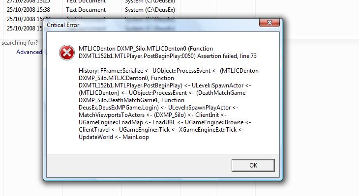

Everytime i try to host deusex shuts down and Says there is an error on line 73 (Dxmtl)

Could you please post your deusex.ini?
(also please check that DXMTL152b1 isn't in your EditPackages)

Hmm... your .ini works for me, no mistakes as far as I can see
try redownloading dxmtl152b1 and replacing your dxmtl152b1.u with a new one

      assert (Level.Game.BaseMutator != None);
      assert (Level.Game.BaseMutator.Class == Class'CBPMutator');
      assert (Level.Game.BaseMutator.NextMutator != None);
      assert (Level.Game.BaseMutator.NextMutator.Class == Class'AntiCheat1');
      assert (Level.SpawnNotify != None);
      assert (Level.SpawnNotify.Next == None);
      assert (Level.SpawnNotify.Class == Class'V30');
One of those requirements are not met. So either there's some wrong shizz within the mutators, or the spawnnotify is not initialized properly, or a custom spawnnotify is used.
