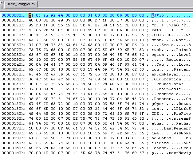

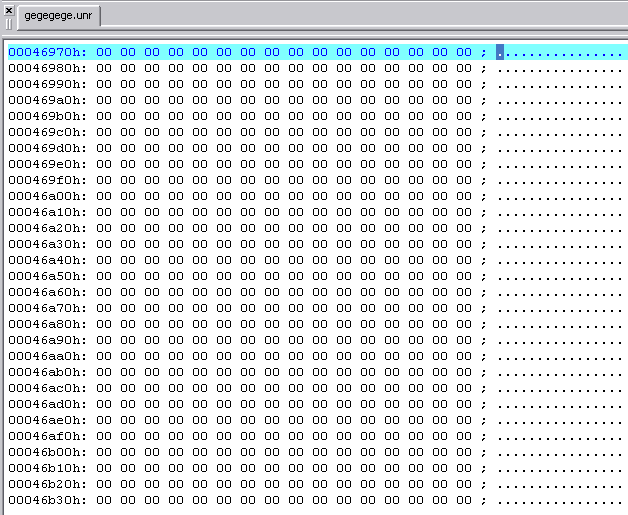

Postby Dae » Sat Feb 18, 06 3:03 pm
You may say "bye" to your map. My apologies, the file of the map doesn't contain anything and those 337 kilobytes of its size are thousands of dots. A program usually fills the file with dots when BSoD (blue screen of death) appears or after program crash (see attachments). This may happen to any program, for example a few weeks ago this happened to my FireFox and i lost all my favourites, configuration, passwords and so on (however i had a backup). Since UED crashes very oftenly and you have a lot of chances to lose your work, I highly recommend you to make backups of your map or maybe set up a special system that does it automatically.
By the way, this is how I lost my FunLine City map when it was over 40%, i had no backups and I had to redo it from the beginning. After this event I set up a backup system that processes backups in .rar every 20 minutes.
Your map.
How it should normally look like.
