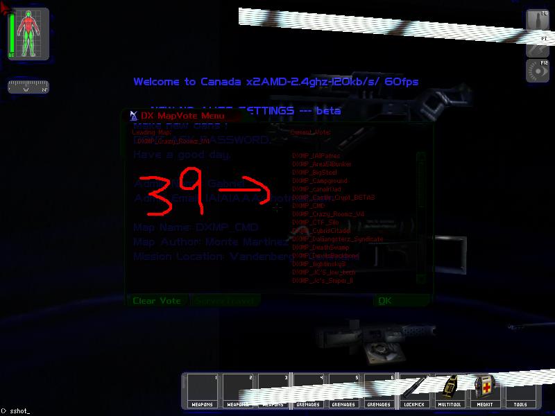

Thanks but there are two servers I have seen recently that have more than 31 maps on thier map list thing, heres a screen shot of one...
There's a server by "undeyingProhecy" or something like that and his server has hundreds of maps on, when its next up I'll take a screen shot.
Sorry its kinda dark...
There are 39 maps in total on that server.

Postby MainMan » Fri Aug 25, 06 2:15 pm
Yeah, if you follow Dae's instructions it will use all your maps, not limiting to 39.

If you didn't understand from my last post, I'll explain. MapVote mutator (this window on screenshot with maps) generates the list of maps from either of two ways:
a). Takes it from Maplist in DeusEx.ini <--- you're limited to 31 map.
b). Generates it from Maps/ folder, independently to DeusEx.ini <-- you're not limited at all.
So, when using way b) you may just put .dx file into Maps/ and it will automatically appear in the list of maps in the mutator.
