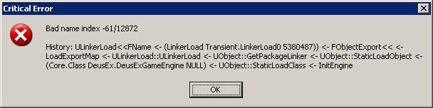

As title says, I can't start up dx anymore, it just gives me a critical error, as you can see on the attachment.

Critical: appError called:
Critical: Bad name index -61/12872
That looks like the cause of the error..
I thought so, seeing as it's mentioned in the critical error screen as well, yet it means nothing to me...

Postby Dae » Sun Jan 07, 07 3:26 pm
I've seen this somewhere before and even managed to fix, but I don't recollect where and how :lol:
First update your MMUserInterface (see Labs) and then try this: rename Cache/ folder to something different, create a new Cache/ folder and launch the game.
Postby Professor Layton » Sun Jan 07, 07 3:34 pm
Updated MMUserInterface and got rid of previous cache, but still gives the error =
Postby Kaiden » Sun Jan 07, 07 3:41 pm
Did you create a NEW cache folder? :wink:
Postby Professor Layton » Sun Jan 07, 07 3:44 pm
Yeah.
Postby Snakey » Sun Jan 07, 07 4:21 pm
Marije got you.
Postby Professor Layton » Sun Jan 07, 07 4:39 pm
Problem got solved, apparently my deusex.u got corrupt. Thanks to Dae for supplying me a non-corrupted one :D
