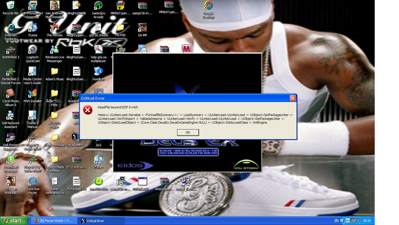

Hey, I have just had this problem with my Deus ex. I am unsure of what to do, could you please help?

Your DeusEx.u is corrupted.
Extract contents of .zip to DeusEx/System.

I get that error when i start up DX not when joining a server
Wgat should i do to fix the corruption?

~[A]Daedalus~ wrote:Your DeusEx.u is corrupted.
Read like 3 posts up^^ and download the attachment.

Postby Dae » Mon Feb 12, 07 8:48 am
Then something else is corrupted :S I think it's easier to reinstall the game (SlimLine). If you want to keep your settings, backup your .ini.

[EDIT] i may have found the problem, my engine.u file is 0kb's maybe thats it ?

Postby Dae » Mon Feb 12, 07 8:30 pm
Good thing that you managed to find it by yourself :D

heh. ye it took a long time since there was no other reason why the game wouldnt work
