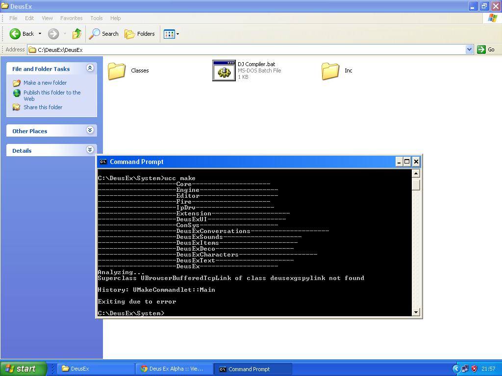

Postby ~DJ~ » Mon Jan 23, 12 4:25 pm
Umm... okay.. How about let's do it from the beginning?
First of all I'd say that it'll be wise to just delete 'DeusEx' subfolder (C:\DeusEx\DeusEx\).. so we're all starting new.
Next you should open SDK and on the Classes section, press Export All.
Now you'll see that there's the 'DeusEx' subfolder present in there again.
I'm gonna advise you to have a batch file in the subfolder called 'Compiler' or so to easily compile it.. I'm attaching it as well on the file I'm providing which I'll mention below.
Hopefully this is going to work.. now I'm also going to attach the 'Headers' Poor spoke of. I'm not sure as if DeusEx.u requires any or not but anyhow..
So here's an attachment of Headers and a simple Batch file to recompile easily. (if you don't trust the contents of the Batch file just right-click it and press 'Edit')
also note; this contains all the DXHeaders.. as in for all other packages as well, you only need DeusEx folder's headers.. so paste that 'Inc' folder in your 'DeusEx' subfolder.
GOOD LUCK :oops:
DxHeaders.zip
(988.19 KiB) Downloaded 2066 times

Postby RedDynasty » Thu Apr 05, 12 10:02 pm
I also have this problem but i cant fix it, even with the Incs and the Compiler.
What im trying to do is edit the PlayMusicWindow.uc to put a music in the list so it shows up when i do the "legend" cheat.
Screenshot here.

Postby ~DJ~ » Fri Apr 06, 12 4:42 pm
Umm.. try adding UBrowser in EditPackages lines.. above DeusEx I suppose..
Like this:
EditPackages=UBrowser
EditPackages=DeusEx
Postby RedDynasty » Fri Apr 06, 12 5:08 pm
well it did start parsing and analising, except that it shows up an error regarding the playmusicwindow.uc class and the menuscreenhostgame.uc ( probably cause i installed that DXMTL thing with the 300+ maps and fixes)
I dont want to reinstall again, but anyways thanks for the help.

Postby ~DJ~ » Fri Apr 06, 12 5:26 pm
I don't think so.. you've probably edited the PlayMusicWindow.. you shouldn't stop here mate..
if you feel that you can't fix the error, just post the class here.
By the way, use this:
EditPackages=Core
EditPackages=Engine
EditPackages=Editor
EditPackages=Fire
EditPackages=IpDrv
EditPackages=UWindow
EditPackages=Extension
EditPackages=DeusExUI
EditPackages=ConSys
EditPackages=DeusExConversations
EditPackages=DeusExSounds
EditPackages=DeusExItems
EditPackages=DeusExDeco
EditPackages=DeusExCharacters
EditPackages=MPCharacters
EditPackages=DeusExText
EditPackages=IpServer
EditPackages=DeusEx
It's taken from default configure file.. you probably have messed up the order (well the screenshot shows that you have completely removed the line.. ).. so yeah, use that instead. :oops:
