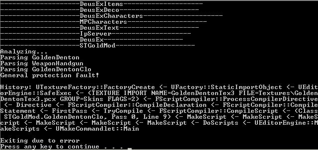

Postby ~DJ~ » Tue Feb 19, 08 11:13 pm
Sorry dint mention the whole error. it happens when i "Ucc Make" to make the package :S. here is the picture.
Postby Dae » Tue Feb 19, 08 11:56 pm
Oh well, you forgot to convert your textures to 8bit format.
The easiest would be to convert to .GIF, and then back to .PCX.
Like it says here.

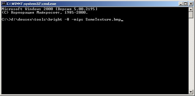

Postby Andrievskaya Veronika » Fri Mar 14, 08 5:48 am
¥~ÐJ~¥, run CMD.exe , because Bright is a console program :)
Type bright /? to get help about command line switches
See screenShot.
