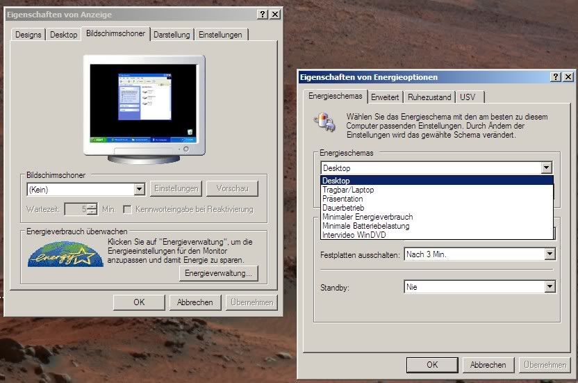

Postby al'be:do » Thu Feb 16, 06 2:30 pm
It's simply an AMD Energy saving processor "problem". If you are using Windows you simply have to set "Desktop" in the energy settings, not "minimum energy use".
(Unfortunately the German Windows version, but it should be obvious, though.)
The cause for the fast gameplay is that in energy saving mode (cool'n quiet) the processor multiplicator goes down and the cpu clock runs at e.g. 800MHz. This is the clock rate before the CPU is used by the game. If you start the game the CPU detection of DeusEx reads this Value and uses it instead of the 2000 MHz the game is actually running with (this is the full clock rate of my Athlon 64 3200+). So in my case everything in the game runs faster by the factor 2000/800 = 2.5.
The same problem occurs with Unreal, UT, Infiltration and all other Unreal Engine based games or mods.
